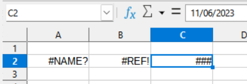

As an example, Figure 1 shows the error code returned when a column is too narrow to display the entire formatted date. The date displayed within the input line, 11/06/2023, would fit within the cell without a problem, but the format used by the cell produces the date value Monday, November 6, 2023.
Figure 1: Error codes displayed within cells
When the cell displaying the #REF! error code in Figure 1 is selected, the Status bar displays the error message as shown in Figure 2. This message is more descriptive than the message displayed in the cell, but it still may not provide enough information to correctly diagnose the problem. For fuller explanations, consult the following tables and the Help topic, Error Codes in LibreOffice Calc.
Figure 2: An error message displayed in the Status bar
