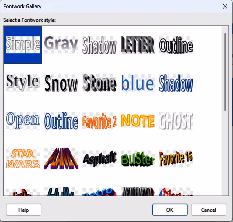

Fontwork
Using Fontwork, graphical text art objects are created to make a presentation more attractive. There are many different settings for text art objects (line, area, position, size, and so on) giving a large selection of effects. Fontwork is also available in LibreOffice Writer, Calc, and Draw modules, but there are small differences in the way that each module displays Fontwork. For more information about Fontwork, see the Getting Started Guide.
Creating Fontwork
  1. Go to Insert > Fontwork on the Menu bar to open the Fontwork Gallery dialog (Figure 47).
  2. Select a Fontwork style from the dialog and click OK. The selected Fontwork appears centrally on the slide and the dialog closes.
  3. Double-click on the Fontwork text graphic to switch on editing mode.
Figure 47: Fontwork Gallery dialog

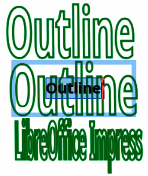

  1. Type in the required text to replace the default text in the Fontwork graphic and the text appears over the default text as shown by the example in Figure 48.
  2. Press the Esc key, or click outside the Fontwork graphic, and the inserted text replaces default text.
Figure 48: Example of creating Fontwork object
