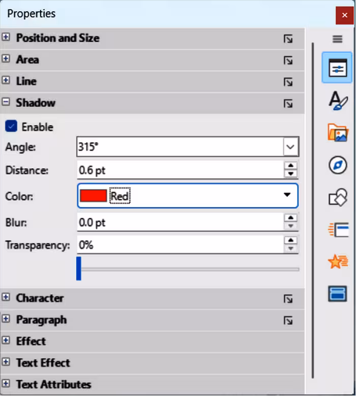

Line shadows
To quickly apply a shadow to a line, click on Shadow on the Line and Filling toolbar. This creates a shadow using the settings from the Shadow page in the Line dialog.
The Shadow page of the Line dialog (Figure 6) provides options for adding and formatting a line shadow. The shadow settings in this dialog are the same as the shadow settings used for object areas. However, shadow settings for a line can be different from the shadow settings used for object areas. For more information on shadow settings, see “Working with shadows” below.

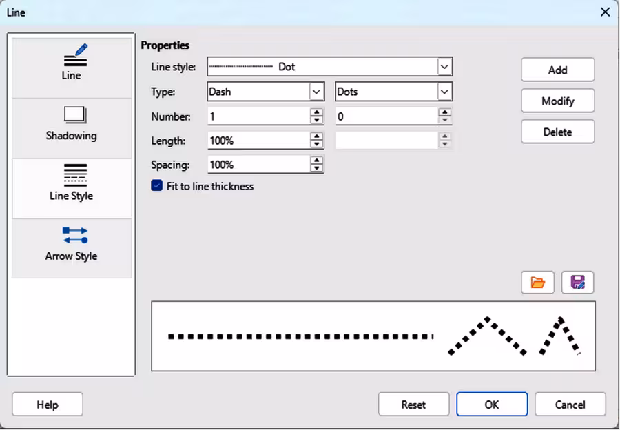

Line styles
Line styles are used in a drawing when adding several lines of similar types reducing the need to format individual lines and LibreOffice provides line styles for line formatting. Also, line styles can be created, saved, and deleted.
The Line Styles page in the Line dialog (Figure 7) provides options for line styles and to create or change line styles. An example of the line style selected or created is displayed at the bottom of the Line Styles page.
Creating line styles
  1. Create a line on a slide.
  2. Open the Line dialog using one of the following methods:
  1. Select from the Line style drop-down menu a predefined line style that is similar to the line style being created.
  2. Click Add and type a name for the new line style in the Name dialog that opens, then click OK to close the dialog. The name of the new style appears in the Line style box.
Figure 7: Line dialog — Line Styles page
  1. In the Type drop-down lists, select Dots or Dash. For lines with only dots or dashes, select the same type in both Type boxes.
  2. In Number, specify the number of dots or dashes required. For different sized groups of dots or dashes, set a different quantity number in each Number box.
  3. In Length, specify the length percentage for dashes. Length is not available if Dots has been selected for Type.
  4. In Spacing, set a spacing percentage between the dots and/or dashes.
  5. If necessary, select Fit to line width so that the new style fits the width of the selected line.
  6. The new line style created is available only in the current document. To use the new line style in other documents, click on Save Line Styles and type a unique filename in the Save as dialog that opens. Saved line styles have the file extension of SOD.
  7. To use a previously created line style, click on Load Line Styles, then select a style from the list of saved styles and click on Open to load the style into the document.
  8. If necessary, click on Modify to change the name of the style and follow Steps 4 thru 11 to create and use a new line style.
  9. Click OK to save any changes and close the Line dialog.
When creating line styles, it is recommended to use a unique name for the line style. This prevents any predefined line styles in LibreOffice from being overwritten causing formatting problems in other documents using predefined line styles.

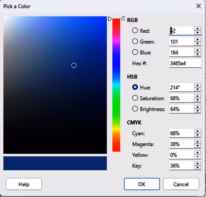

The color notations are linked and changing the value in one set, automatically changes the values in the other sets.
Figure 13: Pick a Color dialog
Pick a Color dialog

Creating colors with Pick a Color dialog
  1. Select an object so that the selection handles are displayed.
  2. Open the Area dialog and click on Area to open the Area page, then click on Color to open the options available for a color fill.
  3. Click on Pick to open the Pick a Color dialog (Figure 13).
  4. Create a new color using one of the following methods. A preview of the color created is shown in the colored box on the left side of the original color.
  1. Click OK to close the Pick a Color dialog.
  2. Click on Add in Custom Palette and enter a name for the color in the Name dialog that opens.
  3. Click OK to close the Name dialog and the color is added to the Custom Palette.
  4. Click OK to save the changes and close the Area dialog. The new color appears as a fill in the selected object.

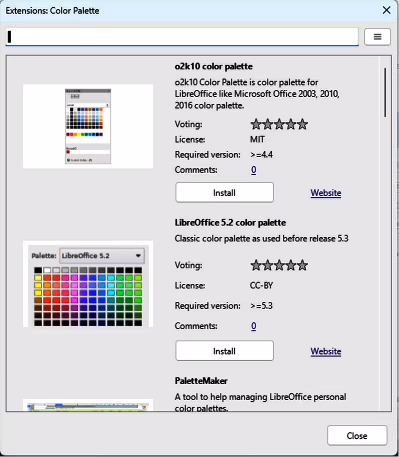

Adding color palettes
Color palettes that are compatible with LibreOffice can be added using Extensions: Color Palettes as follows:
  1. Select an object for editing and open the Area dialog.
  2. Click on Area to open the Area page, then click on Color to open the options available for a color fill.
  3. In Colors, click on Add color palettes via extension to open the Extensions: Color Palette dialog (Figure 14).
  4. Select a color palette from the list of available color palette extensions and click on Install to install the extension into LibreOffice.
  5. Click on Close to close the Extensions: Color Palette dialog and the color palette appears in the Palette drop-down list ready for use.
Figure 14: Extensions Color Palette dialog
Shadows can be applied to objects such as lines, shapes and text. The options available for shadows are as follows:
Use shadow
This option must be selected to use a shadow with an object. Only available in the Shadow page of the Area dialog (Figure 23).
Figure 23: Area dialog — Shadowing page
Enable
This option must be selected to use a shadow with an object. Only available in the Shadow panel in the Properties deck on the Sidebar (Figure 24).
Position grid
Select one of nine points determining the direction in which the shadow is cast from the object. Only available in the Shadow page of the Area dialog (Figure 23).
Angle
Determines the angle in which the shadow is cast from the object. Only available in the Shadow panel in the Properties deck on the Sidebar (Figure 24).
Figure 24: Sidebar Properties deck — Shadow panel
Color
Sets the color used for the shadow.
Distance
Determines the offset distance between the object and the shadow.
Blur
Sets how much the edges of a shadow are blurred or softened.
Transparency
Determines the amount of transparency for the shadow: 0% opaque shadow, 100% transparent shadow.
Area dialog
  1. Select an object where a shadow is going to be applied.
  2. Open the Area dialog and click on Shadow to open the Shadow page (Figure 23).
  3. Select Use shadow in Properties and the shadow options become active.
  4. Select from one of nine points in the position grid the direction in which the shadow is going to be cast in relation to the object.
  5. In Color, select the color palette from the drop-down list of available palettes, then select the color required for the shadow.
  6. In Distance, enter a distance to set spacing between the object and the shadow.
  7. In Blur, enter a value to soften the edges of the shadow.
  8. In Transparency, enter the percentage in the text box for the shadow transparency.
  9. Click OK to close the Area dialog and save the changes.
Sidebar
  2. Click on Properties to open the Properties deck on the Sidebar.
  3. Click on Shadow to open the Shadow panel in the Properties deck (Figure 24).
  4. Select Enable and the shadow options become active.
  5. In Angle, select from one of the options available from the drop-down list to set the direction of where the shadow is going to be cast in relation to the object.
  7. In Color, select the color palette from the drop-down list of available palettes and then select the color required for the shadow.
  8. In Blur, enter a value to soften the edges of the shadow.
  9. In Transparency, move the slider or enter a percentage in the text box to set the shadow transparency.
  10. Deselect the object to save the changes made.

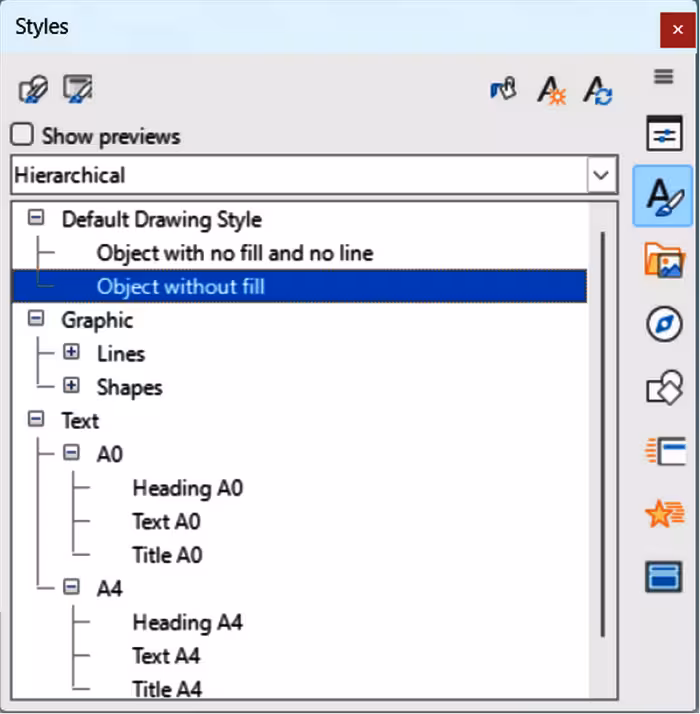

In Impress, the drawing styles are located in the Styles deck on the Sidebar (Figure 32). Click on Drawing Styles to open the drawing styles that are available in the presentation. The Default Drawing Style cannot be deleted and is automatically applied to any graphic object created on a slide. This style is the starting point for creating new drawing styles.
The Default Drawing Style can be modified, but only applies to the presentation where the Default Drawing Style was modified.
Figure 32: Sidebar Styles deck — Drawing Styles panel
