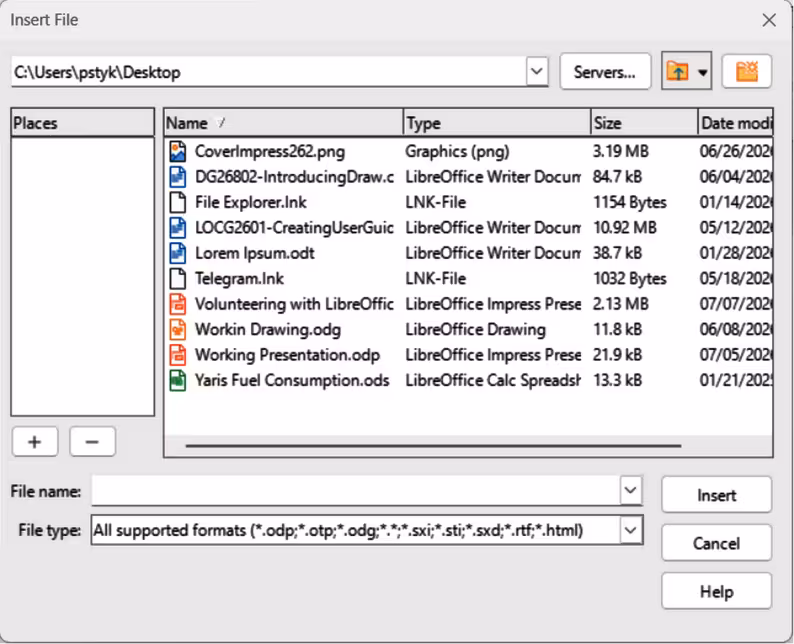

  1. Open an existing presentation or create a new presentation in Impress.
  2. Make sure Normal view is selected in the Workspace and select the position where the slides are going to be inserted into the presentation. See "Inserting new slides"  for inserting slides into a presentation.
  3. Go to Slide > Insert Slide from File on the Menu bar to open the Insert File dialog (Figure 1).
  4. Navigate to where the required slide(s) is located and select the file.
Figure 1: Insert File dialog

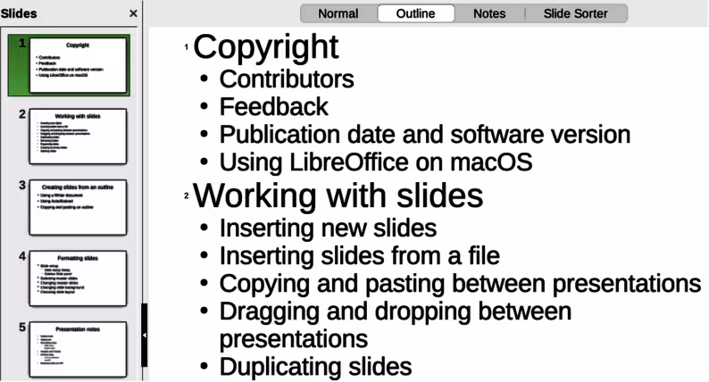

Creating slides from an outline
When planning a presentation it is recommended to develop an outline from a Writer file. Once the outline is created, one or more separate slides can be created from each of the top level outline elements.
Using Writer document
To create a presentation from a Writer document, the Writer document must contain headings formatted using heading paragraph styles.
  1. Open the file in Writer that is going to be used as a basis to create a presentation outline.
  2. Go to File > Send > Outline to Presentation on the Writer Menu bar. A new presentation is created and opens in Impress Outline view. Heading paragraph styles are converted into the Impress outline styles. An example outline from a Writer document is shown in Figure 5.
  3. If necessary, duplicate, or expand slides, and manually change slide contents to create a presentation. For more information, see “Duplicating slides” above and “Expanding slides” above.
Figure 5: Example creating outline from LO Writer document

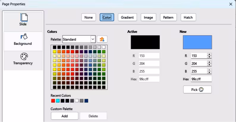

Changing slide background
  1. Make sure Normal view is selected in the Workspace.
  2. Select a slide in the presentation.
Only one slide background in a presentation is changed at a time. To change the background on multiple slides, master slides have to be used. For more information, see Chapter 2, Master Slides, Styles and Templates.
  1. Open the Slide Properties dialog using one of the following methods:
  1. Click on Background to open the Background page (Figure 13) and select the type of background required. For more information on background types, see Chapter 2, Master Slides, Styles, and Templates, and Chapter 6, Formatting Graphic Objects.
  2. Select from the various options for each background type to create a background for a slide.
  3. Click OK to save the changes to the background and close the Slide Properties dialog.
Figure 13: Slide Properties dialog — Background Color page

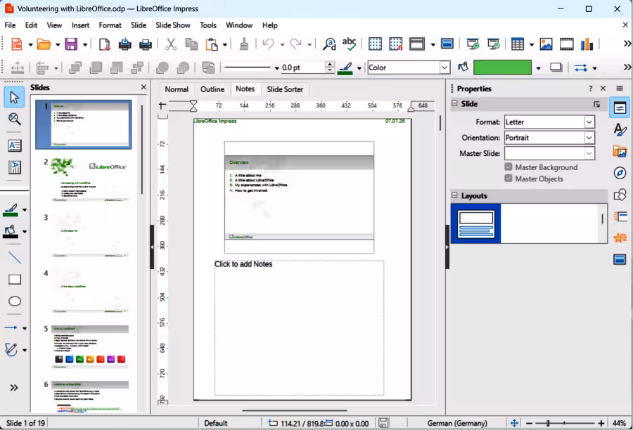

  1. Select a slide to add notes to and open the Notes view (Figure 15) using one of the following methods:
  1. Click on Click to add notes below the slide then type or paste text or graphics as required into the notes box.
  2. To add notes to another slide, repeat Steps 1 and 2.
  3. When adding notes is complete, return to Normal view in the Workspace.
Figure 15: Example of Workspace Notes view

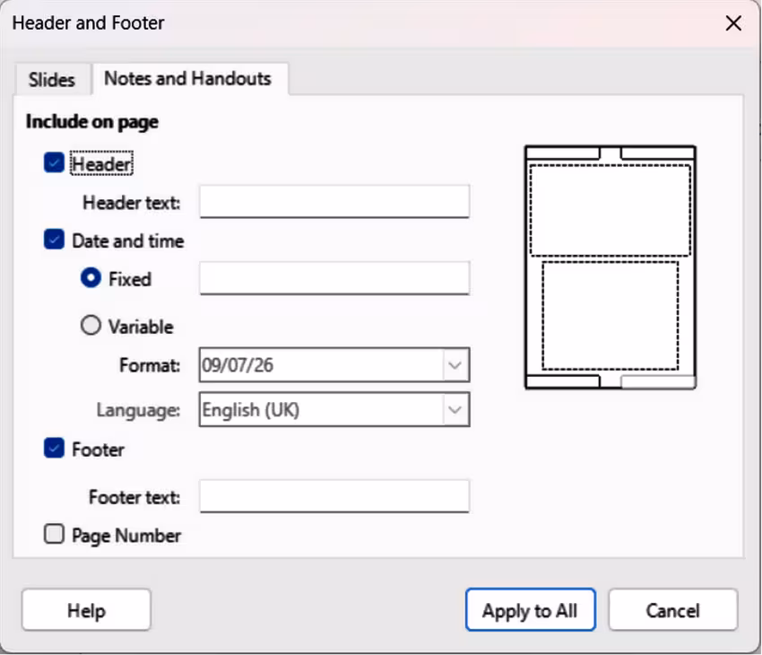

  3. Go to Insert > Header and Footer on the Menu bar to open the Header and Footer dialog (Figure 19).
  4. Click on Notes and Handouts to open the Notes and Handouts page.
Figure 19: Header and Footer dialog — Notes and Handouts page
  1. To add header text to the notes page, select Header and enter the text for the header in the Header text text box.
  2. To add the date and time to the notes page, select Date and time and enter a fixed or variable date and time as follows:
  1. To add footer text to the notes page, select Footer and enter the text for the footer in the Footer text text box.
  2. To add page numbers to the notes page, select Page Number so that the page number appears on each notes page in a presentation.
  3. Click on Apply to All to save the changes and close the Header and Footer dialog.

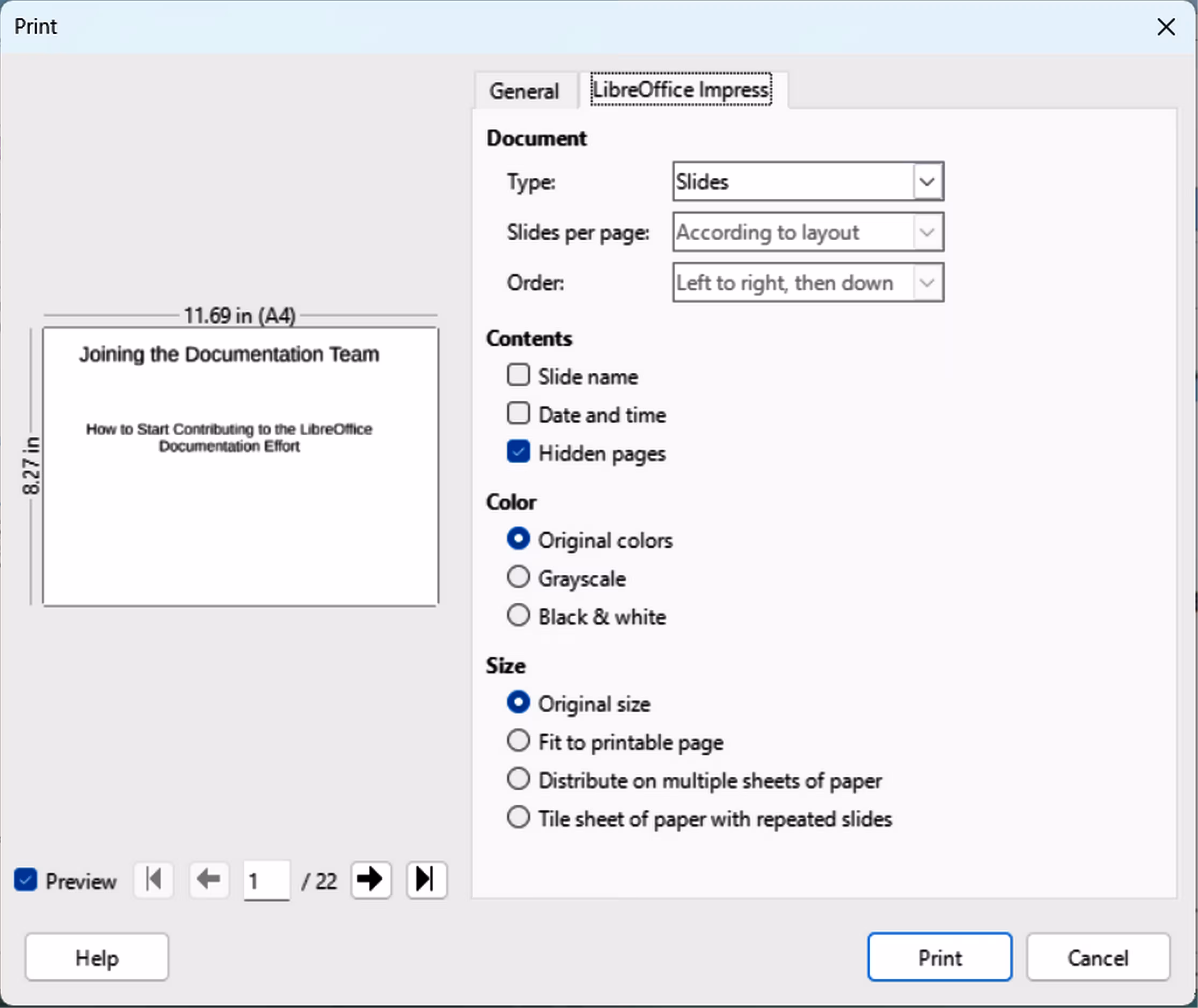

  1. Select a slide that has notes added and open the Notes view. See “Adding notes” above.
  2. Go to File > Print on the Menu bar, or use the keyboard shortcut Ctrl+P to open the Print dialog (Figure 20).
  3. Select LibreOffice Impress to open the LibreOffice Impress page and access the options for printing notes.
  4. In Document, select Notes from the Type drop-down list.
  5. In Contents, Color, and Size, select any additional options that are required, for example Slide name, Original colors, Fit to printable page.
  6. Click OK to print and close the Print dialog.

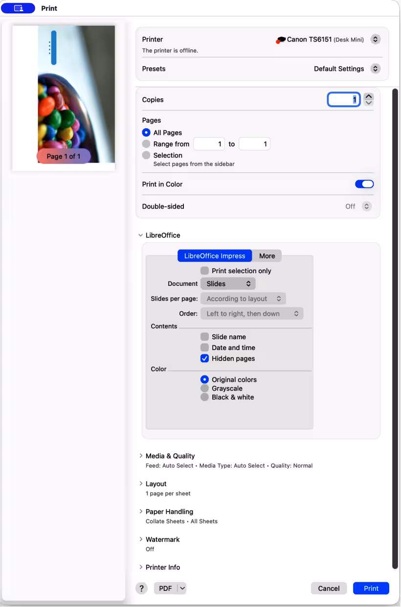

macOS
  2. Go to File > Print on the Menu bar, or use the keyboard shortcut ⌘+P to open the Print dialog (Figure 21).
Figure 21: Print dialog — LibreOffice Impress Notes — macOS
  1. In LibreOffice, select LibreOffice Impress then select the following options:
  1. Click on More and make sure that Original size and All slides are selected.
  2. Click OK to print and close the Print dialog.

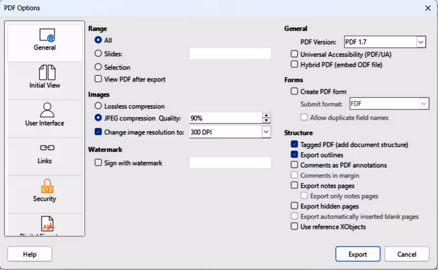

Exporting notes as PDF
The PDF contains separate pages for the slides and the notes. For example, if a presentation has 10 slides, the PDF file contains 20 pages consisting of 10 pages of individual slides followed by 10 pages of notes. All pages are formatted for the paper size selected.
The following PDF export is an example only. Actual export procedure does depend on computer setup, operating system and the type of printer connected to the computer.
  2. Go to File > Export As > Export as PDF on the Menu bar to open the PDF Options dialog (Figure 22).
  3. Click on General to open the General page.
  4. In Structure, select the option Export notes pages.
  5. If required, select Export only notes pages to create a PDF file that only contains the presentation notes.
  6. If required, open the remaining pages in the PDF Options dialog and select any required options to create a PDF file.
Figure 22: PDF Options dialog — General page
  1. Click on Export to open a file browser window and navigate to the folder where the PDF file is to be saved.
  2. Enter a filename, then click on Export or Save to save the file in the designated folder closing the file browser window and PDF Options dialog.

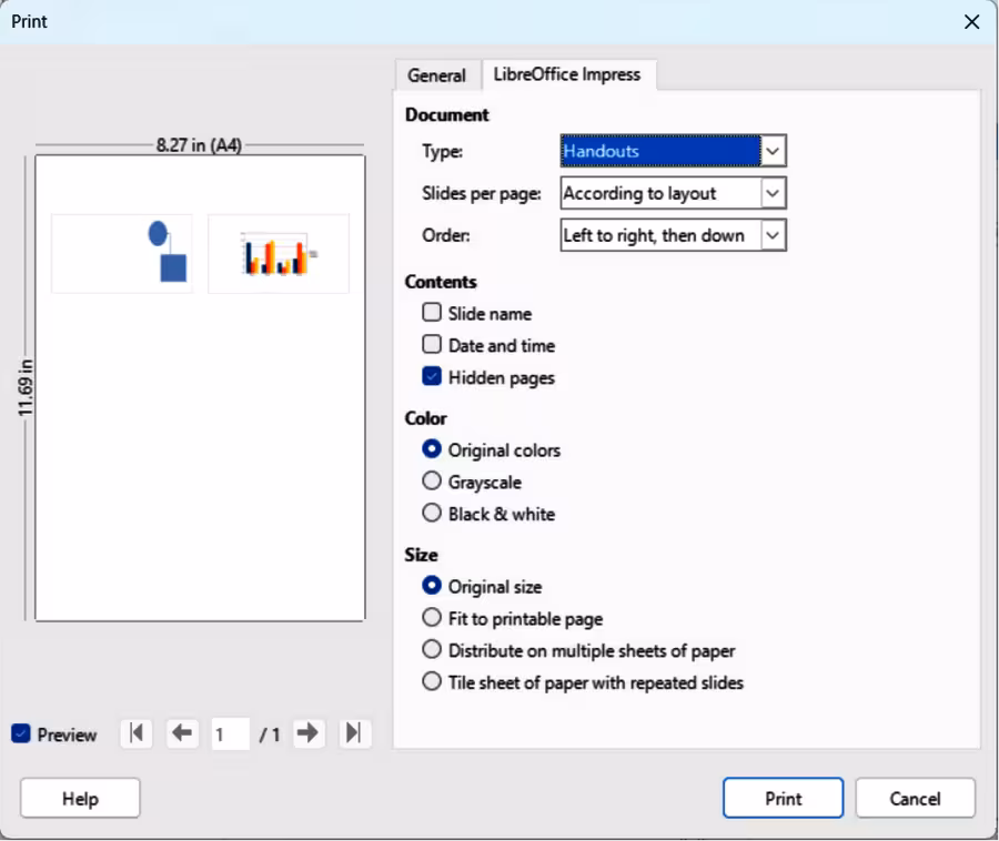

  1. Go to File > Print on the Menu bar, or use the keyboard shortcut Ctrl+P (macOS ⌘+P) to open the Print dialog.
Figure 23: Print dialog — LibreOffice Impress — Handouts page
  1. For Linux or Windows, click on LibreOffice Impress to open the page for handout printing and select the printing options from the Document drop–down lists as follows:
  1. For macOS, make sure LibreOffice is selected and select the printing options from the LibreOffice Impress drop–down lists as follows:
  1. In Contents, select Slide name, Date and time, or Hidden pages if one or all of these options are to be printed on the handouts.
  2. In Color, select one option on how the handouts are printed.
  3. In Size, select one option on how the handouts are printed.
  4. Click on Print to print the handouts and close the Print dialog.
