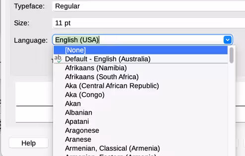

The language selected for a document (on Tools > Options > Language Settings > Languages) determines the dictionary used for spelling, thesaurus, hyphenation, the decimal and thousands delimiter used, and the default currency format.
Within the document, you can apply a separate language to any paragraph style. This setting has priority over the language of the whole document.
On the Font tab of the Paragraph Style dialog, languages with installed dictionaries are marked in the Language list by a small icon (Figure 8). When checking spelling, Writer will use the correct dictionary for paragraphs with this style.
If you write documents in multiple languages, you can use the linked styles to create two paragraph styles that differ only in the language option. If you then want to change some of the other properties of the paragraph style, all you need do is to change the parent style.
Figure 8: Selecting a language for a paragraph style
To insert occasional words in a different language and avoid their being picked by mistake with the spelling checker, it is more convenient to use a character style, as discussed in “Creating a new character style” below.
Tip
The selection [None] for Language is useful when a paragraph includes text you don’t want checked, like URLs and programming code.

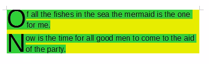

Drop caps (one or more characters in a larger font at the beginning of a paragraph) are generally suitable only for a first paragraph style. To define the properties of a drop cap, use the Drop Caps tab of the Paragraph Style dialog.
Figure 13: Options for adding a drop cap to a paragraph style
Select the Display drop caps option to enable the other choices: the number of lines occupied, the number of characters to enlarge (if you want the whole first word, check the corresponding box), and the space between the drop caps and the text.
Drop caps use the same font and have the same properties as the rest of the paragraph; however, you can easily modify their appearance by creating a specific character style and using it. For example, you may want the drop caps to be of a different color or apply an outline effect. Select the character style you want to use in the corresponding drop-down menu.
Adding a background color, gradient, pattern, hatching, or image to a paragraph is an alternative to using a frame. You can customize the background using the Area tab of the Paragraph Style dialog. The choices are described in Chapter 6, Formatting Pages: Advanced.
Consider the following points when working with the Area tab:
If the desired color is not in the list of predefined ones, you can define your own as described in Chapter 20, Customizing Writer.
You can select different backgrounds for the paragraph area and for the text in the paragraph. Use the Highlighting tab for the text. Figure 14 shows the difference.
The area treatment is applied only to the paragraph area. If you have defined an indented paragraph, the space between the paragraph and the margin does not have the paragraph’s background color.
Figure 14: Different Area and Highlighting colors

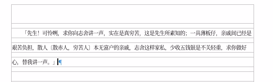

For Asian and Complex text layout documents, use the Text Grid option (Figure 21). By default it is not set however you can set measurements for the layout and display here. When you have this option active the Snap to Text Grid (if active) will be enabled in the Alignment tab of the paragraph style.
Figure 22 shows the lines grid and Figure 23 shows the line and character grid for Asian text.
Note
Asian and Complex text layout options available in Tools > Options > Languages and Locales > General are enabled by default.
Figure 21: Text Grid options
Figure 22: Grid lines for Asian text
Figure 23: Line and character grid for Asian text

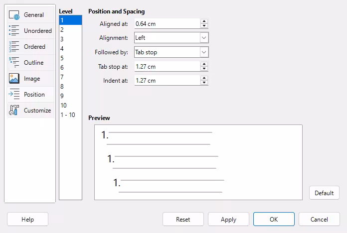

Use the Position tab (Figure 24) to fine tune the indentation and spacing of the list item symbol and the text of the list item. This tab is particularly effective when used in combination with the Customize tab.
Figure 24: Position settings for a List style
You can adjust the following settings for each individual level or all levels at once (to make them all the same).
Aligned at: the position of the numbering symbol, measured from the left margin of the page.
Numbering alignment: Select Left to align the numbering symbol to start directly at the Aligned at position. Select Right to align the symbol to end directly before the Aligned at position. Select Centered to center the symbol around the Aligned at position. This option does not set the alignment of the paragraph, only the numbering symbol.
Numbering followed by: the character to follow the numbering symbol (plus any characters—for example a punctuation mark—chosen on the Customize tab to appear after the number). Choose between a tab stop, a space, or nothing.
Tab stop at: If you selected the tab stop above, you can specify the position of the tab.
Indent at: Specify the distance from the left page margin to the start of all lines in the numbered or bullet paragraph that follow the first line.
