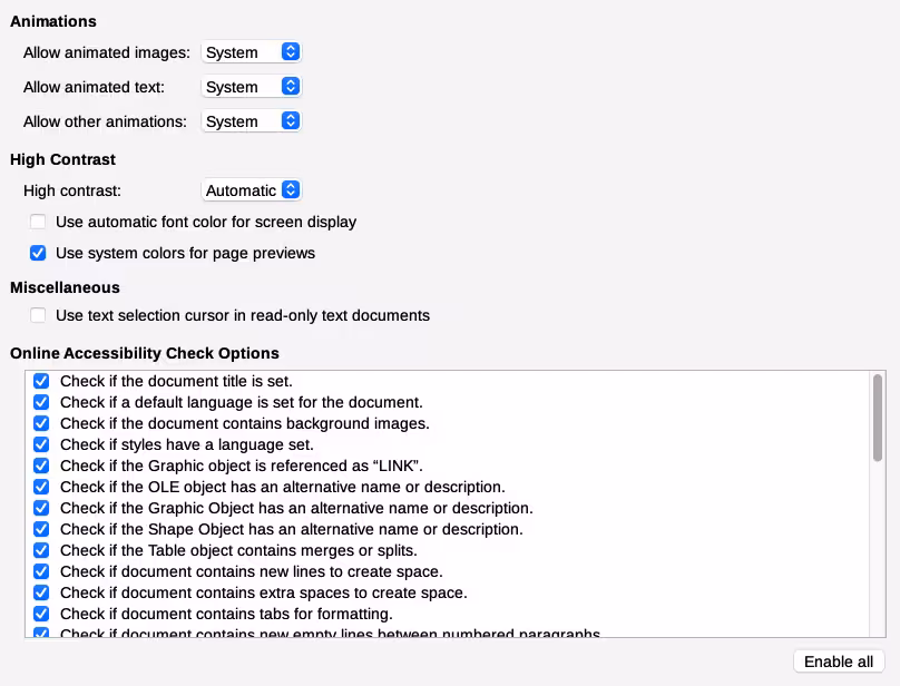

Select options on the LibreOffice Writer – Accessibility page to make the program more accessible for users with reduced sight, limited dexterity, or other disabilities.
Options in the upper portion of this page affect the onscreen display of a document while you are working on it: animations, screen contrast and colors, and text selection by cursor.
In the list of Online Accessibility Check Options, select the items to be checked by default when running an accessibility check on a document. See Chapter 7, Printing and Publishing, in this book and the Getting Started Guide for more about accessibility checking.
Figure 5: Choosing accessibility options

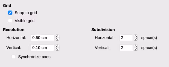

Grid options
Snap to grid automatically moves an object to the nearest gridlines. This can be very helpful when you are trying to align several objects such as graphics or tables.
On the LibreOffice Writer – Grid page (Figure 10), choose whether to enable this feature and what grid intervals to use. If the grid intervals (subdivisions) are too large, you may not have enough control in placing the objects.
Figure 10: Choosing Grid options for Writer

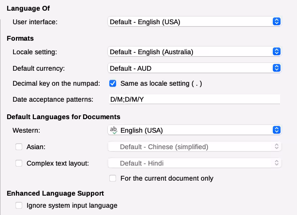

Change some language and locale settings
To change some details of the language and locale settings that LibreOffice uses for all documents or for specific documents, go to the Options dialog, click the expansion symbol (+ sign or triangle) by Languages and Locales, and choose General. On the right-hand side of the Languages and Locales – General page (Figure 18), change the settings as required. See the Help for details on all these options.
In the example shown, the user interface is set to English (USA), but English (Australia) has been chosen for the Locale, which influences settings for numbering, currency, and units of measure.
To apply the language settings to the current document only, instead of being the default for all new documents, select For the current document only.
Changes to the system input language normally affect text typed into a document after the change. To prevent this, select Ignore system input language; new text will then continue to follow the language of the document or the paragraph, not the system language.
Figure 18: Choosing language options
If necessary, select the options to enable support for Asian languages (Chinese, Japanese, Korean) and support for CTL (complex text layout) languages such as Hindi, Thai, Hebrew, and Arabic. If ither of these options is selected, the next time the Options dialog is opened, some extra pages will be listed under Language Settings. These pages are not discussed here.

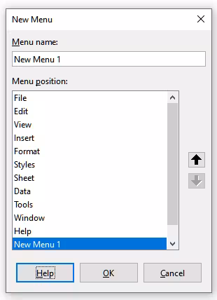

Create a new menu
You might find a “Favorites” menu useful, or a menu collecting tools for a specific project.
To create a new menu:
  1. On the Menus tab of the Customize dialog, click the symbol next to Target and select Add in the drop-down list (Figure 23) to display the New Menu dialog (Figure 24).
Figure 23: Location of command to add a new menu
  1. Type a name for the new menu in the Menu name box.
  2. Use the up and down arrow buttons to move the new menu into the required position on the Menu bar.
  3. Click OK to save and return to the Customize dialog.
The new menu now appears on the list of menus in the Customize dialog. It will appear on the Menu bar itself after you save the customizations.
After creating a new menu, add some commands to it as described above for modifying a menu.
Figure 24: Adding a new menu
Adding a new menu

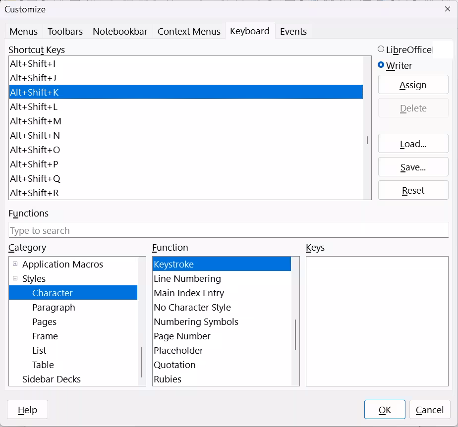

Assigning shortcut keys
In addition to the built-in keyboard shortcuts, you can define others. You can assign shortcuts to standard LibreOffice functions or your own macros and save them for use with Writer or with the entire LibreOffice suite.
To adapt shortcut keys to your needs, use the Keyboard tab of the Customize dialog (Figure 28).
  1. Choose whether to have the shortcut key assignment available in all components of LibreOffice or only in Writer.
  2. Select the desired shortcut key in the Shortcut Keys list at the top of the page.
  3. Select the required function in the Category and Function lists.
  4. Click the Assign button. The selection now appears in the Keys list on the lower right.
  5. Click OK to accept the change.
Repeat as required.
Shortcut keys that are grayed-out in the listing on the Customize dialog, such as F1 and F10, are not available for reassignment.
Figure 28: Defining keyboard shortcuts for applying styles

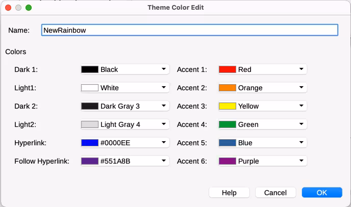

Setting up document themes
Document themes collect various format selections into a set that can be applied and changed with two clicks. This feature is mainly for compatibility with Microsoft Office, through the import and export filter. Theme colors were implemented in LibreOffice Writer 7.6; font and format settings are planned for later releases.
LibreOffice supplies several sets of theme colors. To define your own set:
  1. Choose Format > Theme on the Menu bar. In the Theme dialog (Figure 32), select a theme to use as a starting point and click Add.
  2. In the Theme Color Edit dialog (Figure 33), name the new theme and select colors from any available palette.
  3. Click OK to save the new theme, which will now appear in the Theme dialog.
See Chapter 6, Formatting Pages: Advanced, for instructions on using document themes.
User-defined theme color sets are saved only in the document; to use them in other documents, you need to make a template.
Themes enhance compatibility with Microsoft Word. However, they are not yet part of ODF (OpenDocument Format), so you need to save the document in the ODF 1.3 Extended format (or later) to use them.
Figure 32: Theme dialog
Theme dialog
Figure 33: Creating a new theme
